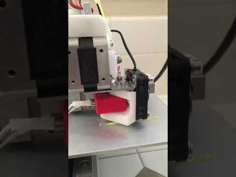

Changed to a different filament. It will print about 3-4 lines and then just STOPs.
Bite marked filament passes easily.

To me, it looks like it is extruding too much.
Are you using the customized print profiles? Have changed line width setting?
What is material and print setting?

@Arnold Results using your generic PLA 220C def, a 0.4mm nozzle and genuine TT PLA are identical to the poor quality prints I have been having. I have no idea what else we can try. I have removed and installed Up Studio numerous times.
What’s weird here is that it looks over extruded and yet, there’s a knocking sound!
