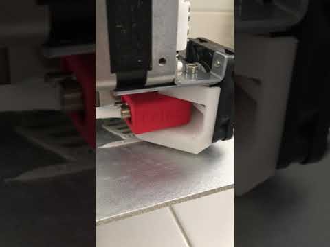

Here’s video of printing process …
Need to see a little more, can you remove the fan and the white duct…then show a video with a view from where the fan was…that includes from the top of the motor to the printed model.
Guess I should have said to record it printing, and hold the camera very still
And just a little further back so I can see the top of the motor as well.

Remove the nozzle, then look at the heater block surface(with the red silicone) underneath where the nozzle enters when installing, it should be flat around the hole…also check the two tubes that attach the heater block to the frame of the extruder assembly, make sure there is no silicone between where the tubes meet the heater block and the two screws/bolts are tight.
Also unlink the filament tube from the cables, and use a length of 50mm…that tube should stay in the white filament-guide.
I don’t understand what you are saying. I have not modified the printer.
that surface doesn’t look flat to me, there are some ridges of aluminum on the right side in your pic.
I’m very confused, that is the way I rec’d it from TierTime. Is it defective?
When I first received my printer I noticed my nozzle wasn’t vertical in the heater-block, a closer look revealed some metal slag around the hole, I removed the extra metal to make the surface flat…as it should be.
