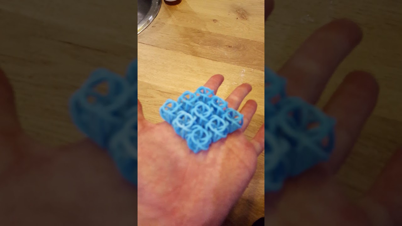

Here is my first real successful print on the glass:
Finally, I’m satisfied. These shims are not a reliable long term solution, but I’m now printing on glass and loving it. When I design a longer term solution for these shims
Rafts were extremely reliable, but wasteful, both time and filament were wasted on many rafts over the last few weeks I’ve had the printer. The bottom finish when printing on glass is smooth as glass.
